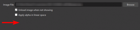

Great plugin, but can you please change the icon being different than the normal image source? Otherwise can not see if a source is using the original obs image or if its your async one :) thx
I already thought about this, but my options are rather limited. OBS doesn't allow creating custom icons (and it also wouldn't sense, since this would break themes support), so I can only choose from the existing ones:
That would mean either using an icon that was actually meant for a different source type, which would be pretty confusing (and also: which one? maybe color source would remotely fit) or using the default custom icon, putting the source in the range of all other non-specific custom sources:
The idea is that it's an image source that is really close to the original in functionality (and it even is from code perspective), meaning in most scenarios it will be a 1:1 replacement for it and then it totally makes sense to me that it also has the image source icon. I feel like if I change the icon now to make you and the half of users happy that want it to be visually distinguishable from the original image source it will make the other half of users complain that although it's an image source it doesn't look like an image source from its icon.
Therefore I'd like to propose 2 things:
  1. Check whether you really need to use the original image source at all - if you really have a use case where you need it, because the async image source doesn't satisfy this need, then I'd like to hear it, maybe it's something I can do about? And if you don't need it, well, then don't use it at all and then you know what type all of your image sources are.
  2. Make it distinguishable yourself by giving it a prefix in the name (something like "[A] My banner" for async or "[O] My screenshot" for original or by using the OBS feature to set a color (right click -> Set Color) on one of the source types.
What do you think?
thx for the detailed response.
The main problem is that there is NO way to see in obs if the original or async element has been used. They just look the same.
At least on the property page, there should be some kind of info, so can be sure its either normal img or async.
If using drag and drop for example, it just adds an element - I guess it is the original one - but there is no way to check difference than scanning the layout file I guess.
- Is there a way to put an animation when the picture changes? Maybe it can use the build in Show/Hide transition or at least a Fade to look more smooth
Outside of what I already suggested (e.g. setting a color for them or a name prefix) there is actually two ways, though I have to admit they're not obvious. One would be to click the plus sign to add a new source, select "Image (Async)", check "Add Existing" and then the list will show you which sources are async sources (or you do the same on the original image source). This will give you an overview at one glance.
Another one if you want to check it for a specific item just select it in the Sources list and check the area above the list on the right. The original image source will show the file path of the image there and a Browse button:
For the async image this area will be empty. This is actually something I didn't plan and only noticed now when looking for differences. One could see it as a missing feature, but now that I realized it can be used to quickly distinguish the two I think I'll just leave it that way.
Unfortunately no. The main idea behind this image source was to stay as close as possible to the original (especially internally/technically) and really only add this one single difference that it's async so that it doesn't cause lags, and I don't think I will steer away from that idea.
If someone wants that they could script something that will hide the source, change the underlying file and then show the source again - combined with hide and show transitions configured for the source you can then have whatever animations you want and you still get the benefit that the async source doesn't cause lags when showing it again (unlike the original source). But such things are outside the scope of this source for me, sorry.
how about a small info text that this is a async source at this position ?
edit: oh ya the source toolbar is a hint for that, thx
As long as I stick to the original options I can use its translations into 61 additional languages, any additional text will immediately look out of place for anything outside of English, because I am always lacking the 61 translations for it. That's also why in the main menu the item is not translated and will always say "Image (Async)" even when your Italian OBS would label the original source as "Immagine". I thought about just putting "(Async)" next to the original text, but then again not all languages would have such addition to the right side of the text, by grammar logic or because it's a right to left written language.
But the one thing I will do here is just put the text "(Async)" at the top of its options on a single line for all languages, then I also don't have to worry about having it right or left of something, so thanks for that idea.
